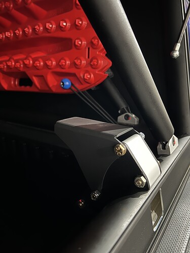

Not really on the GFC, but totally related. I got my Martin Offroad Camper Rack installed on the Colorado!
