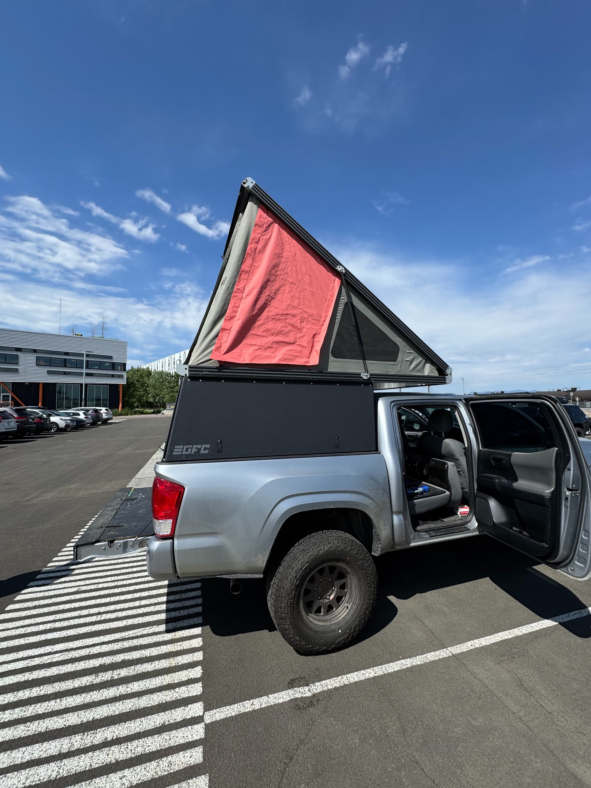

I pulled the tent out and started mapping the new side door. It should be done tomorrow!
got the door and screen added. Just waiting on the zippers now.

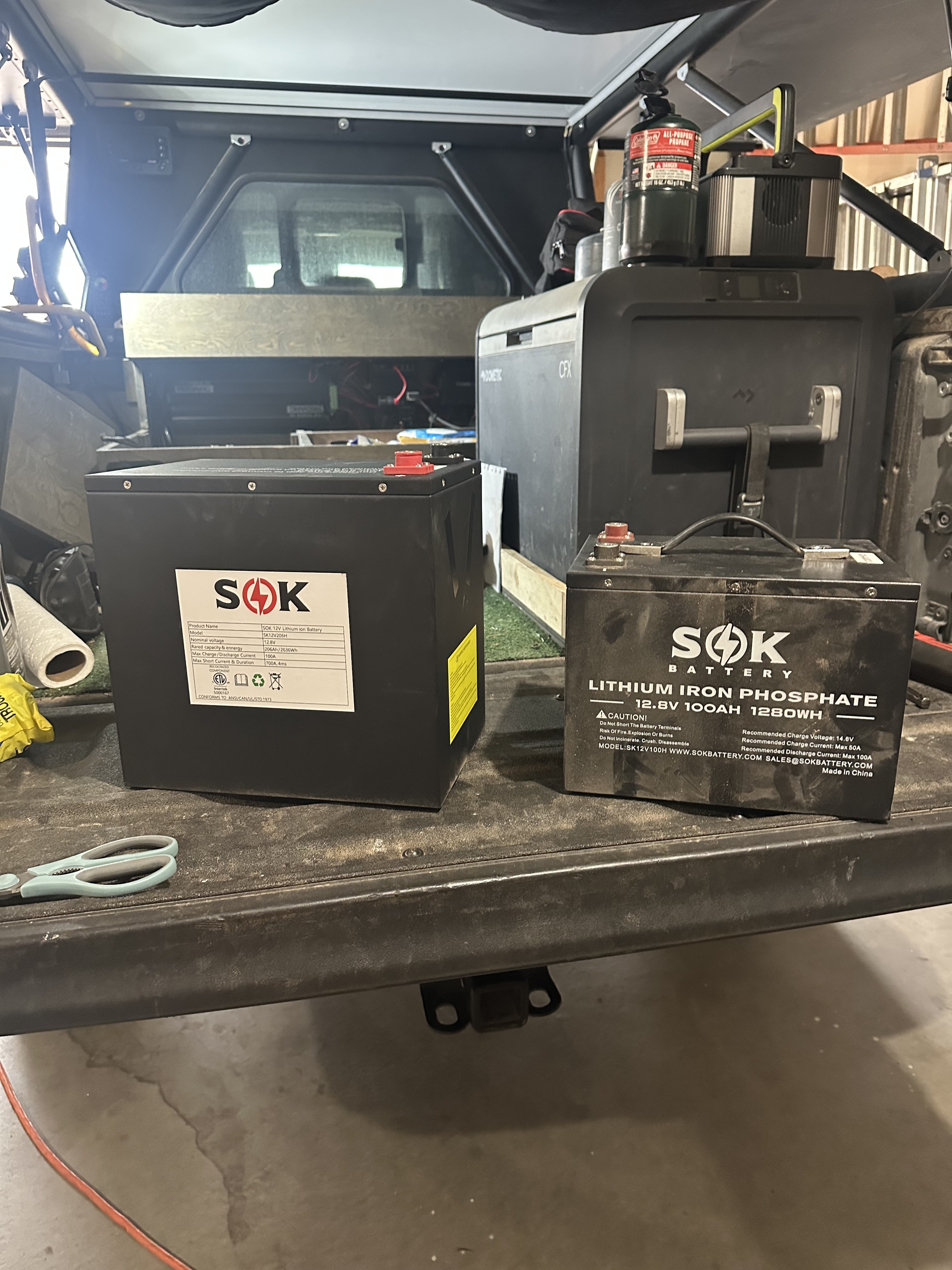

Upgraded my 100ah battery to a 200ah. Luckily I planned ahead for this during my initial build so it only took about 15 minutes.
I did some initial testing. Looks like I should be able to run all my circuits (Starlink, fan, lights, router, media server, and cooler on max) for about 30 hours. In my normal use case scenario it should give me 4 days without starting the Jeep and with no “range anxiety”. Both cases are extreme scenarios.

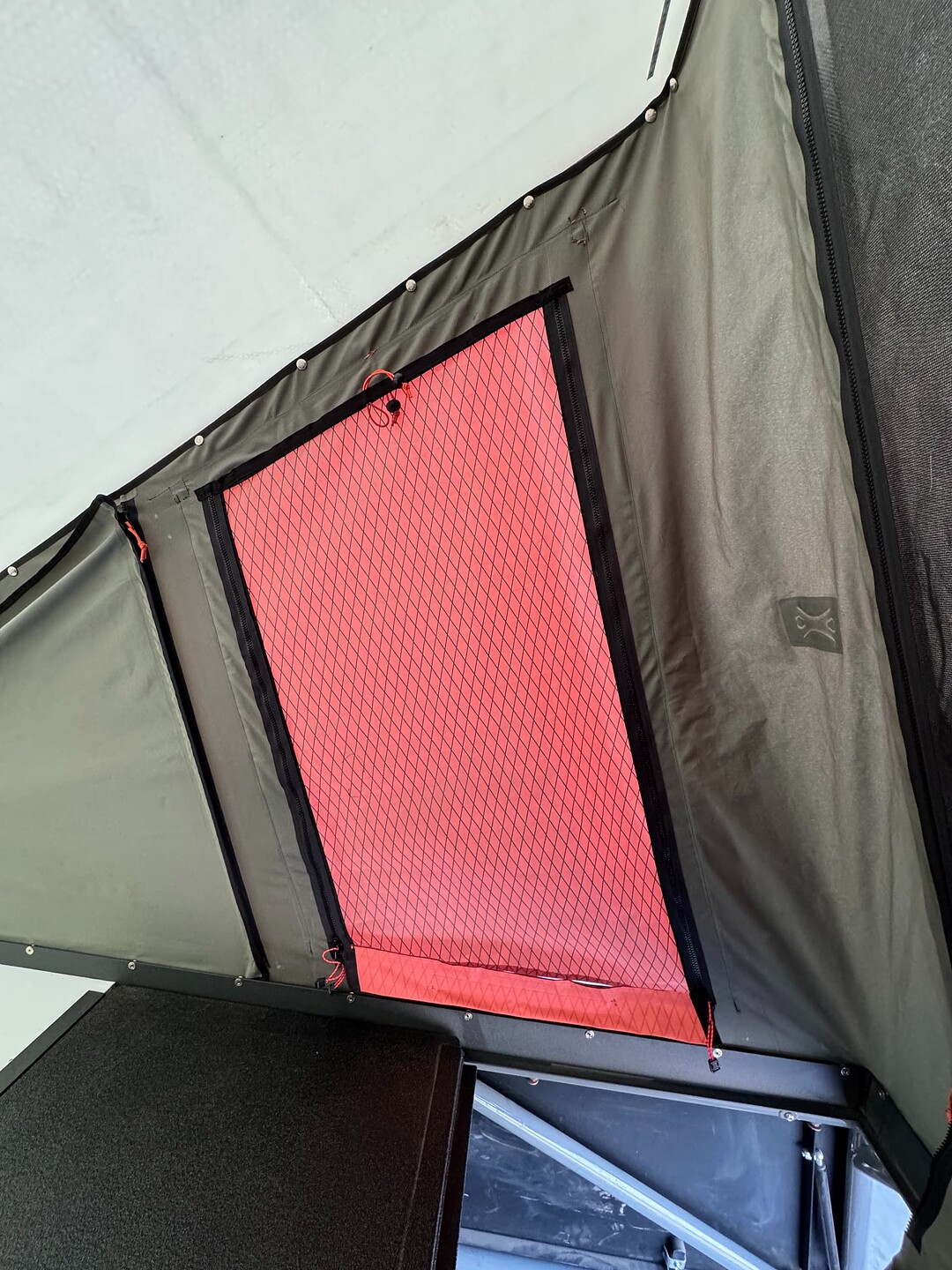

@GFC_Thomas installed the V2 Pro Tent today over at @BasilsGarage
Super stoked, the new tent is definitely an upgrade.
  • New bug screen is smaller and easier to see through. It should keep out the little biters.
  • The new door and window is nice. The ladder wedge thing for the front windows is a cool detail I didn’t know about.
  • Really like the ability to zip down the back door from the top
I was really confused and curious about this, but I think you are referring to the flat shim that allows the small windows to be propped open for air flow while still maintaining privacy…
I agree, it’s a cool functional addition to the tent!
Yes, that’s what I was talking about. Thomas called it a “ladder slot”. Totally see why what I said was confusing. I don’t remember seeing it anywhere in the previews.

got the tent installed today! Need to redo one side as those snaps are a royal pain to get back in lol
I’m glad to hear Basil’s can do the swap. I’m in line to get a V2 Pro tent and cannot wait to get it
Yep, they will be able to do it. I’m very happy with the new tent and haven’t even camped in it yet. Just hung out in it last night checking it out.

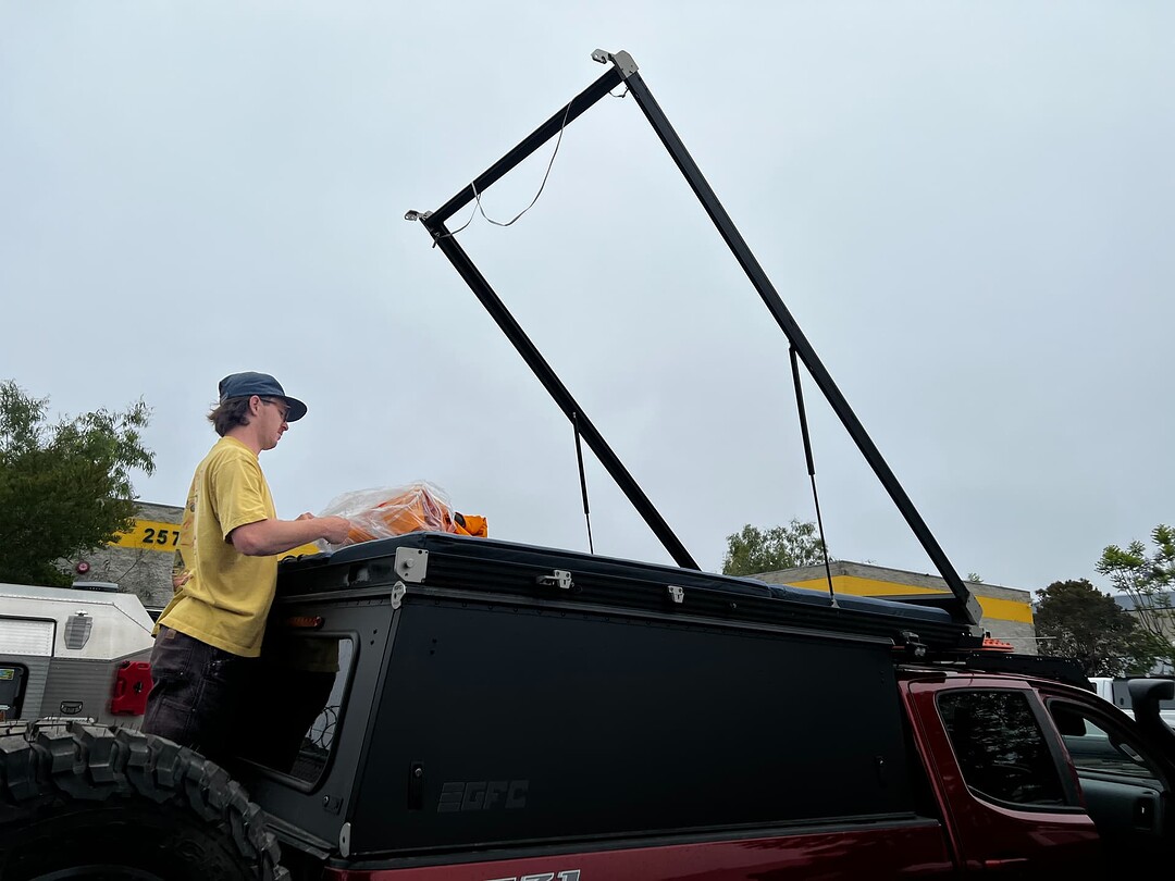

Last week I was playing with updating my ASG awning mount set up
I didn’t like how it was kinda resting on the hinge, I worried that at just the wrong time it could bind up and cause some damage so I played with flipping the lock out of the way
Learned how to use the mirror functions in fusion360
Now they have a home and stay tucked out of the way.

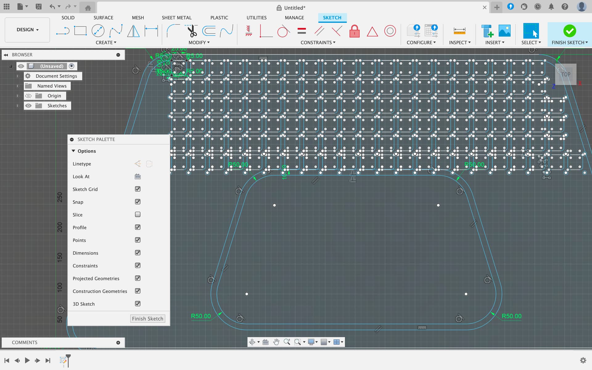

This week I’m filling the void for my Rivian, since I know they are too low volume for anyone to bother measuring/ making
Behold my early attempts at a molle panel
Learning how to repeat stuff like a molle grid with 1/4-20 holes and how to export properly for machining services
Preliminary test shows I can get this cut in aluminum and shipped from sendcutsend for under $250

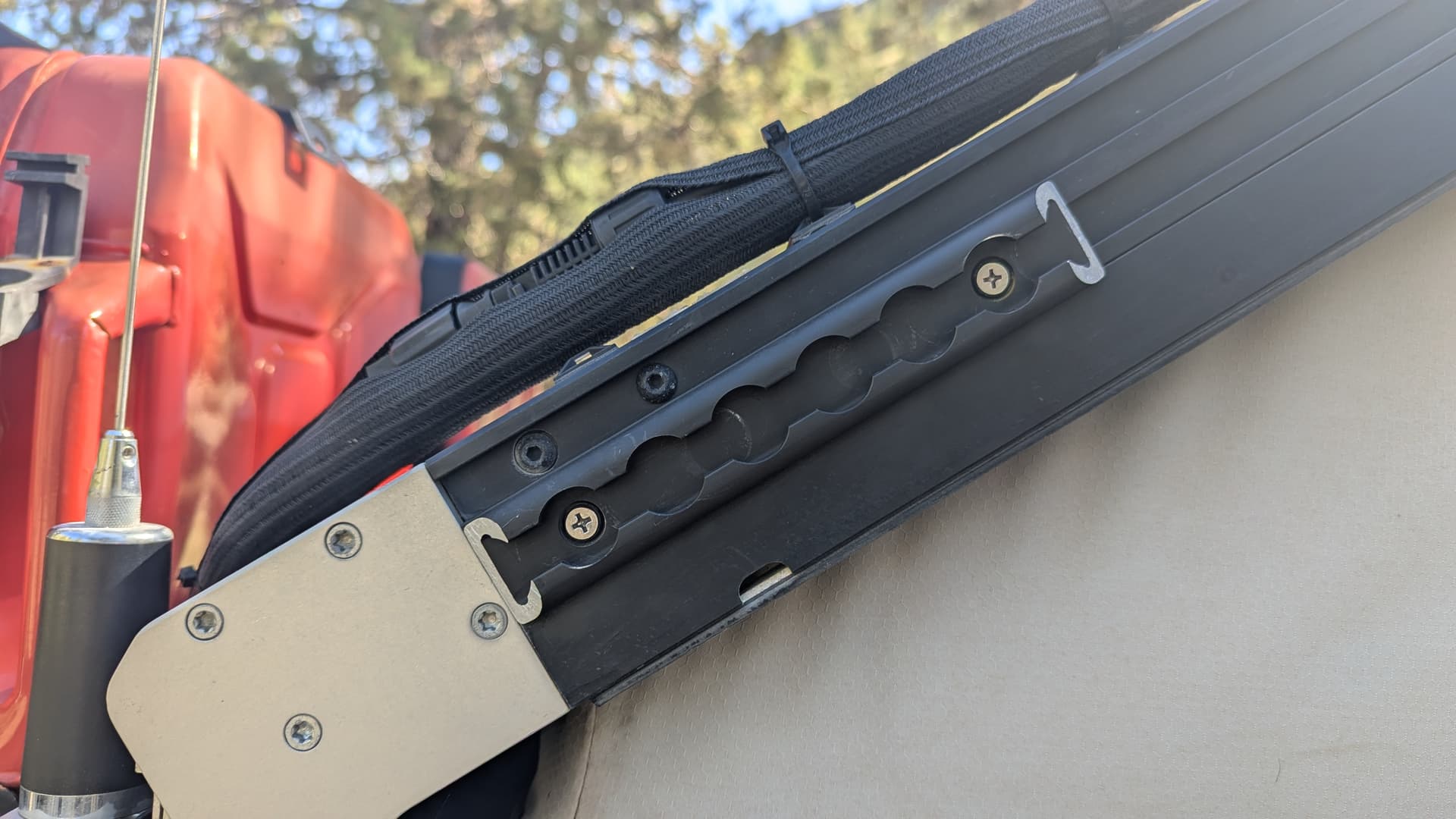

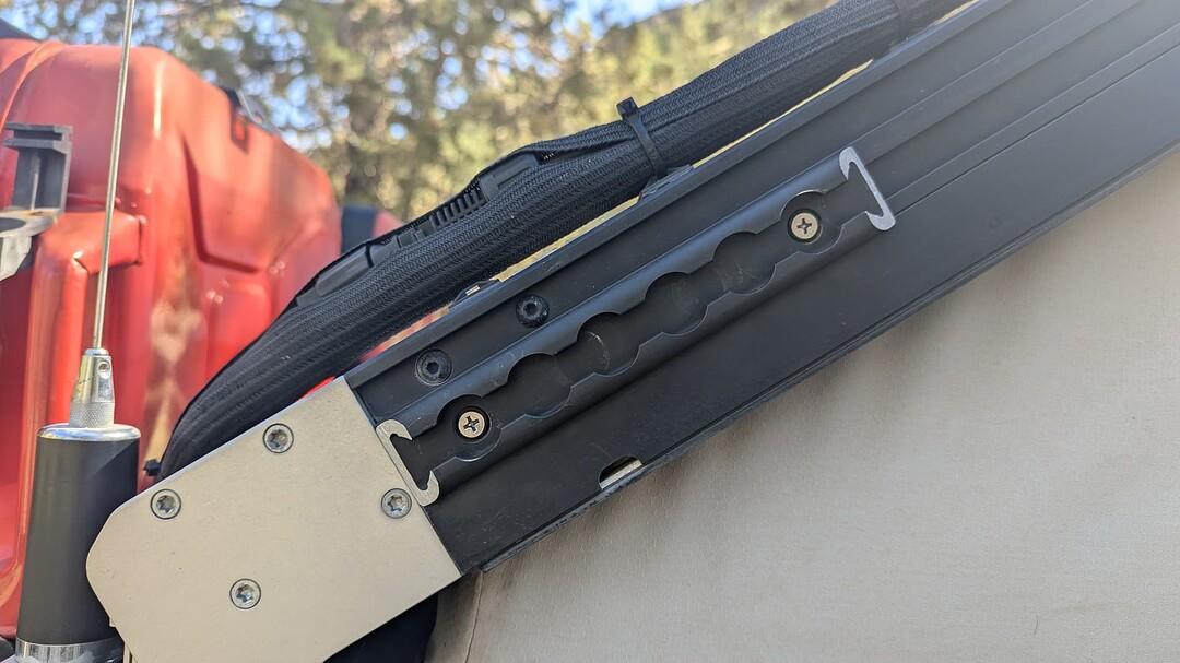

Recently added a short section of L-track to the upper extrusion so that we can hang out shower bag on the side. The different attachment locations allow for some adjustment with bag height.

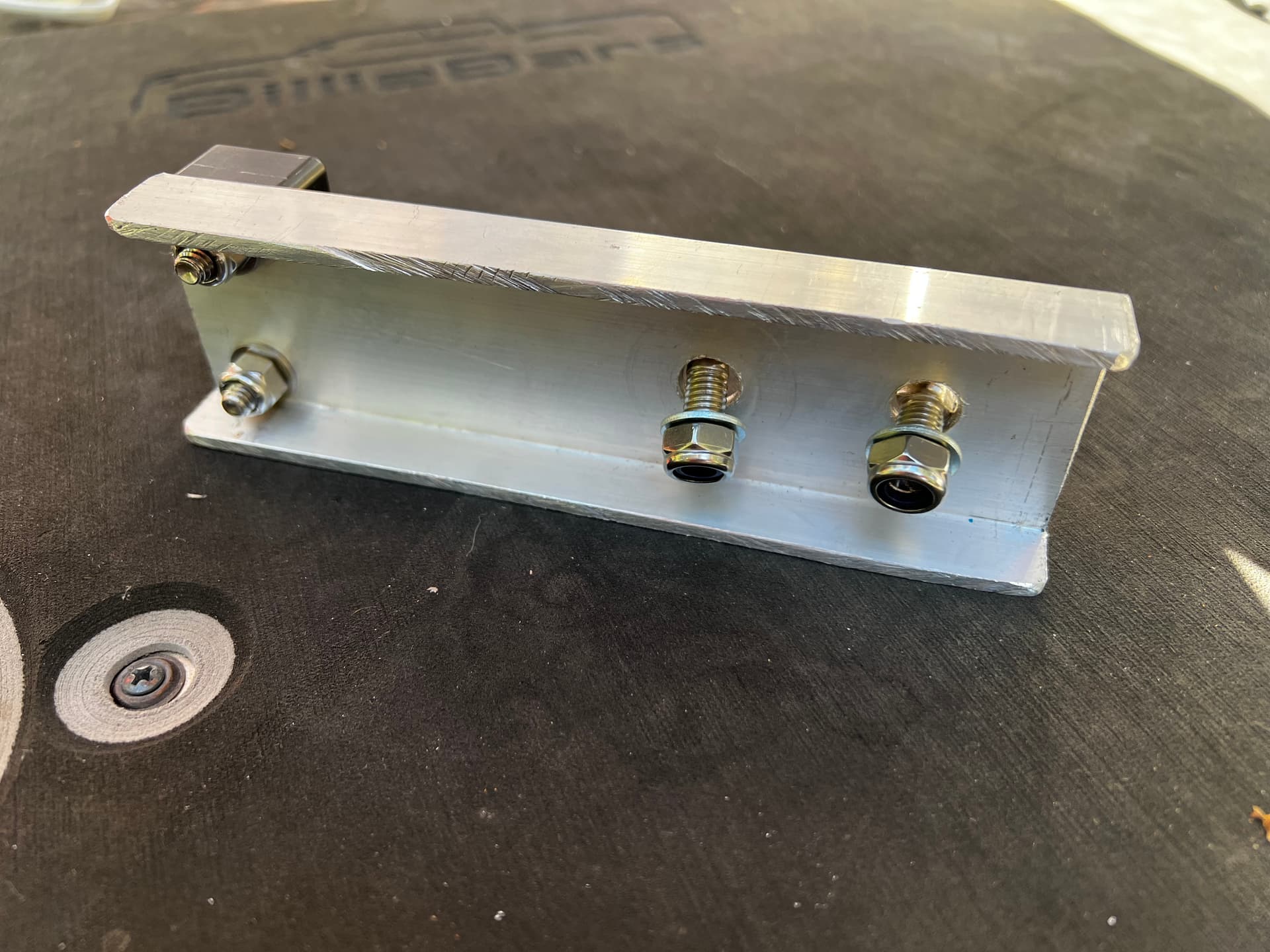

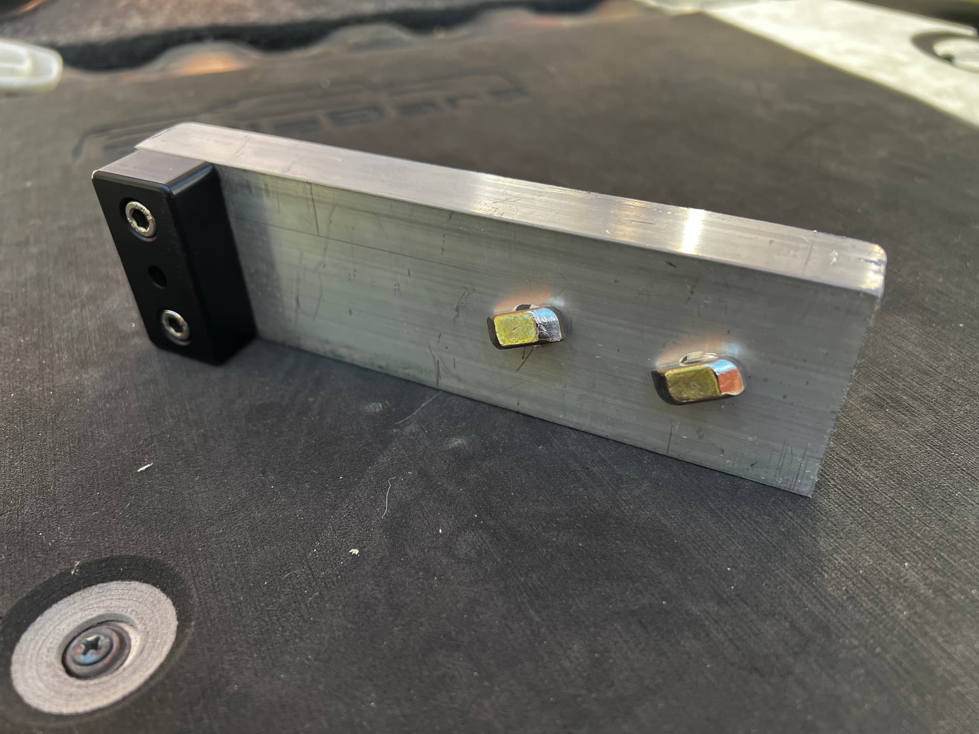

I added a mod so I can use my ShitBrix with my awning. (I saw someone else do it on Youtube)
I call it, the “ShitStax” (@Shittco approved) :smiley:
I attached it to the backside of the awning. I’d suggest figuring out where you want to attach it on the awning, then do it before you mount the awning. Or, you can do it like I did with a lot of patience, swearing, and more patience.
It’s basically 2" extrusion. The sides are 1" deep, which was too much. So I used a hacksaw in a file. It could definitely be done a lot cleaner. But for a a $0 prototype + 15 minutes. I’ll take it!

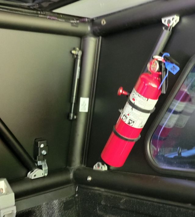

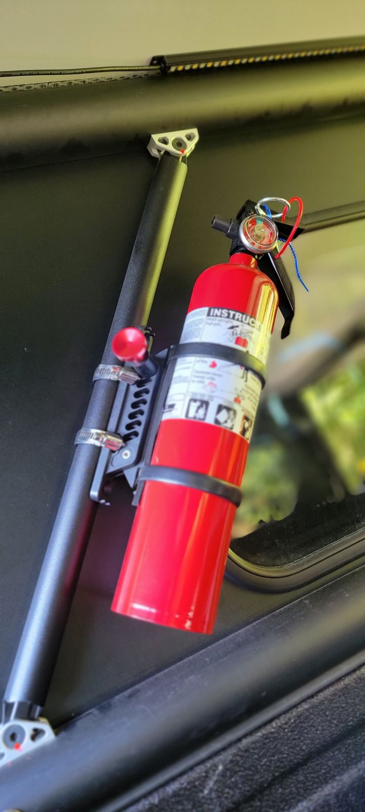

Mounted fire extinguisher to the front support bar. Was not sure this would work out, but so far no movement at all and it is holding up well. Easy to access from the side.
