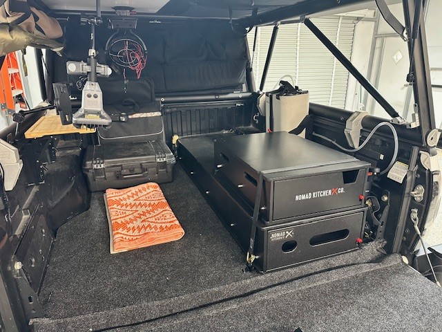

Started reconfiguring the back of the truck yesterday. Installed a bed mat and a Nomad Kitchen LT with drawer. Still a work in progress…

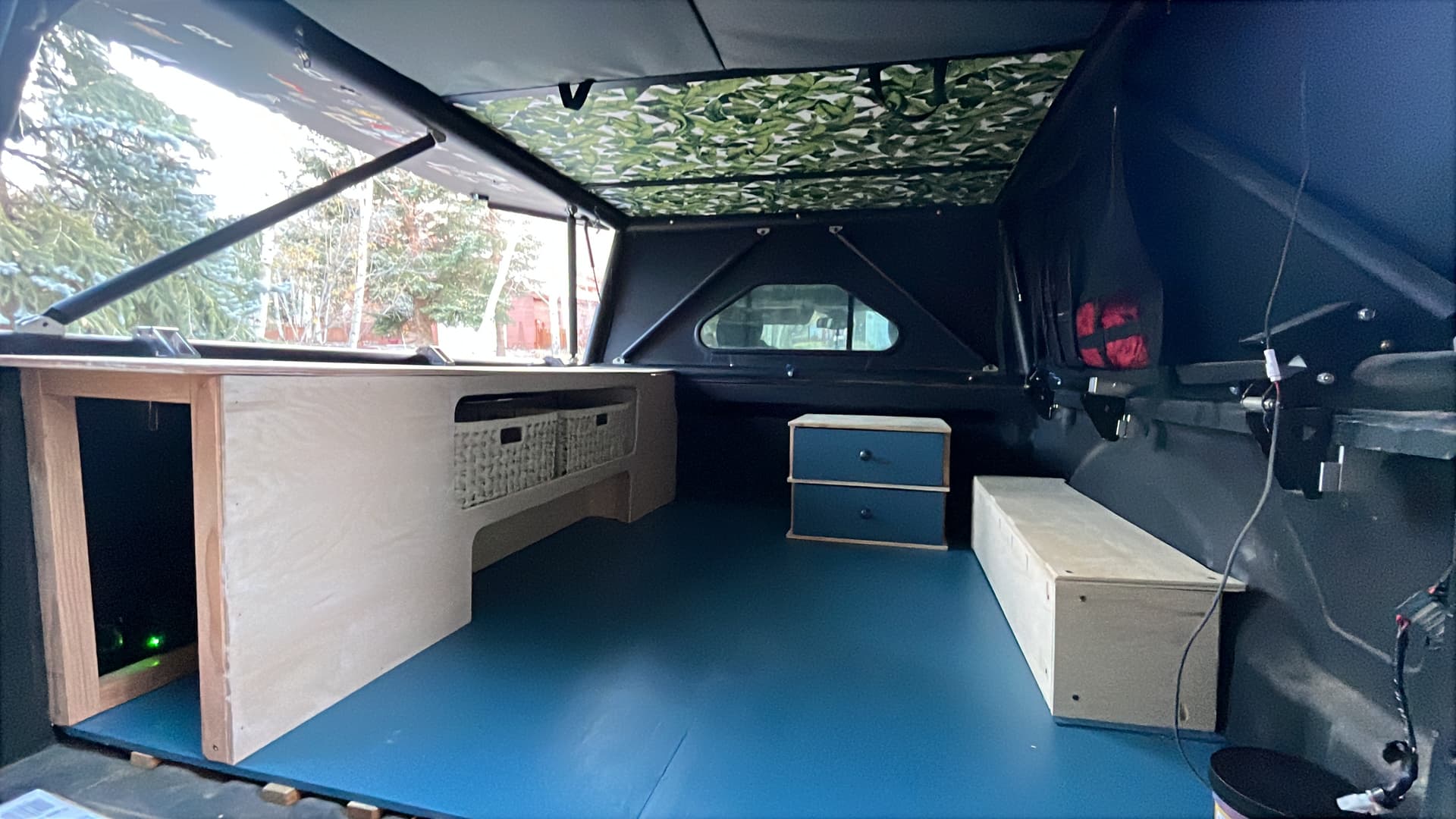

Was busy this weekend. Originally I had a build designed for a topper shell (shelf, bed with drawer), so when I upgraded to the GFC this summer it needed updating. I stripped out my old build and this is phase one of my rebuild. More exciting things to come in a few weeks ![]()
next build steps:
- Build passenger side bench
- Add Laguna folding table
- Install Overhead cabinets
- Add DIY beef bars
- Re-install solar panels (that I lost on the highway
) - Wire in battery and inverter
- Adding led lighting
And more details too.

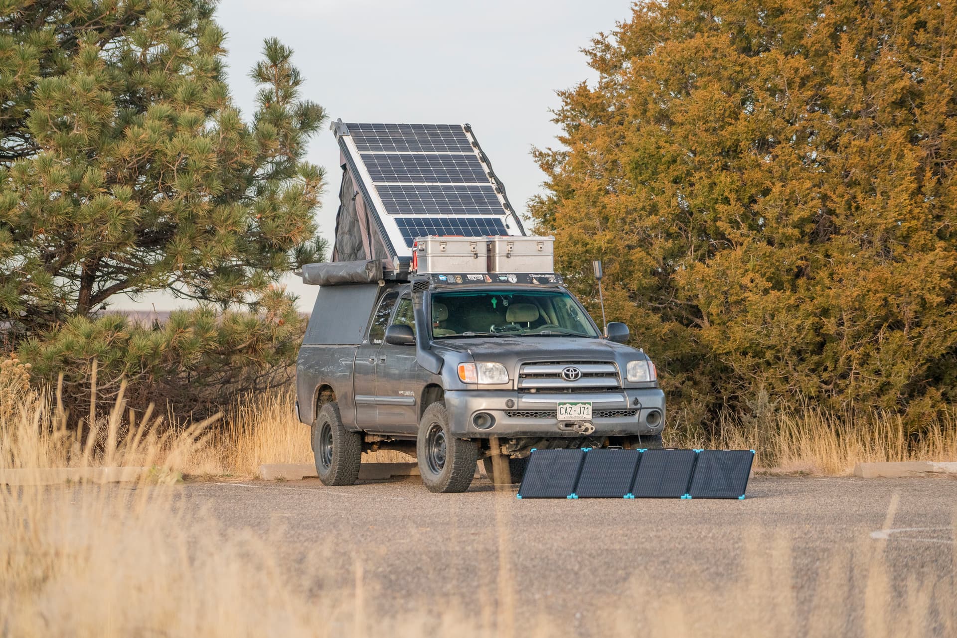

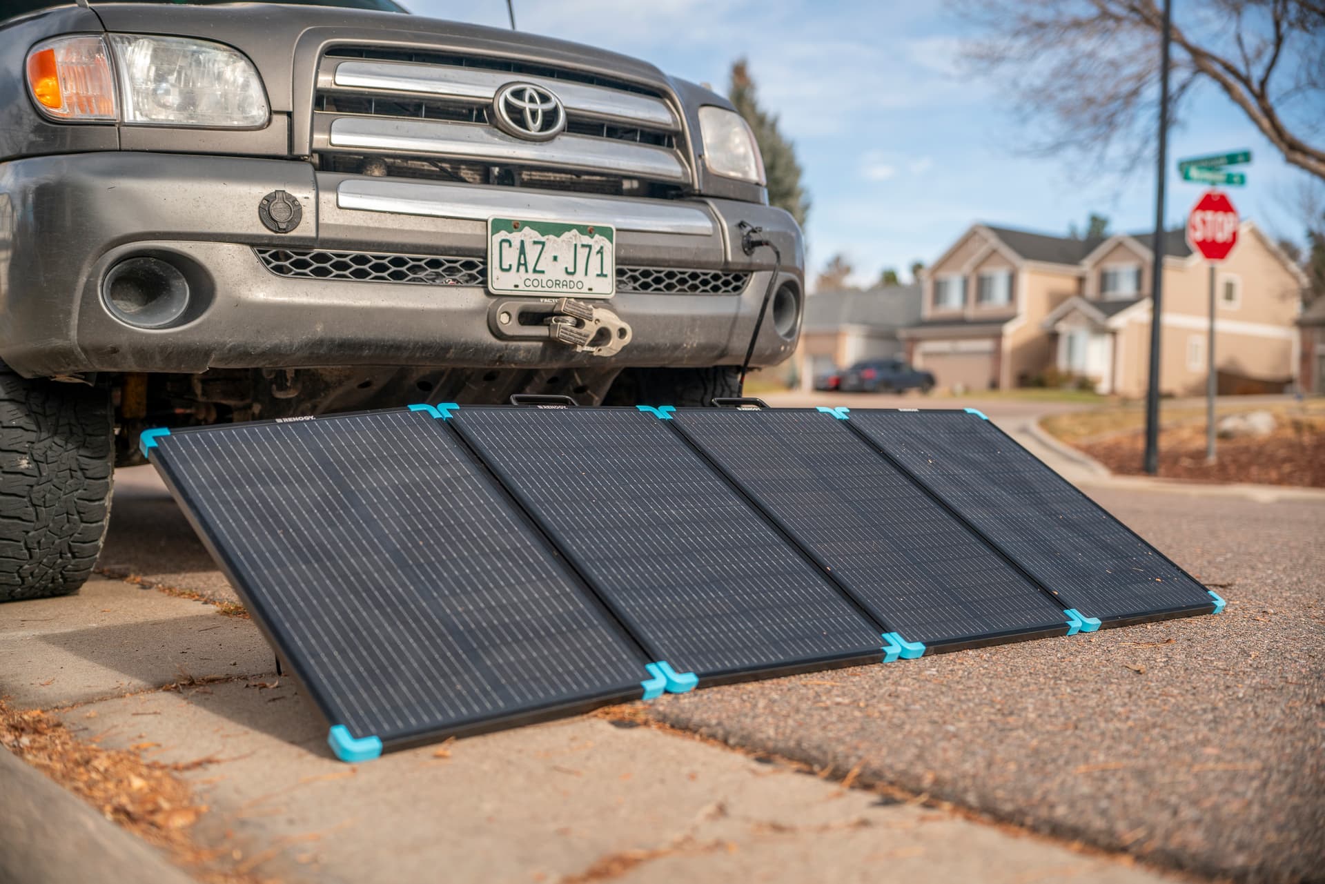

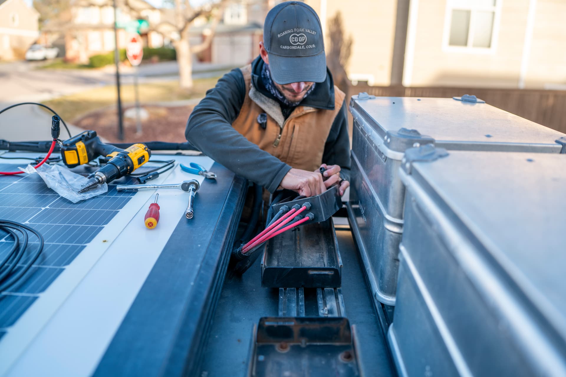

We just added a 4th 100w flexible Renogy Solar panel to our roof, and also added a 220w Renogy ground panel to the mix.

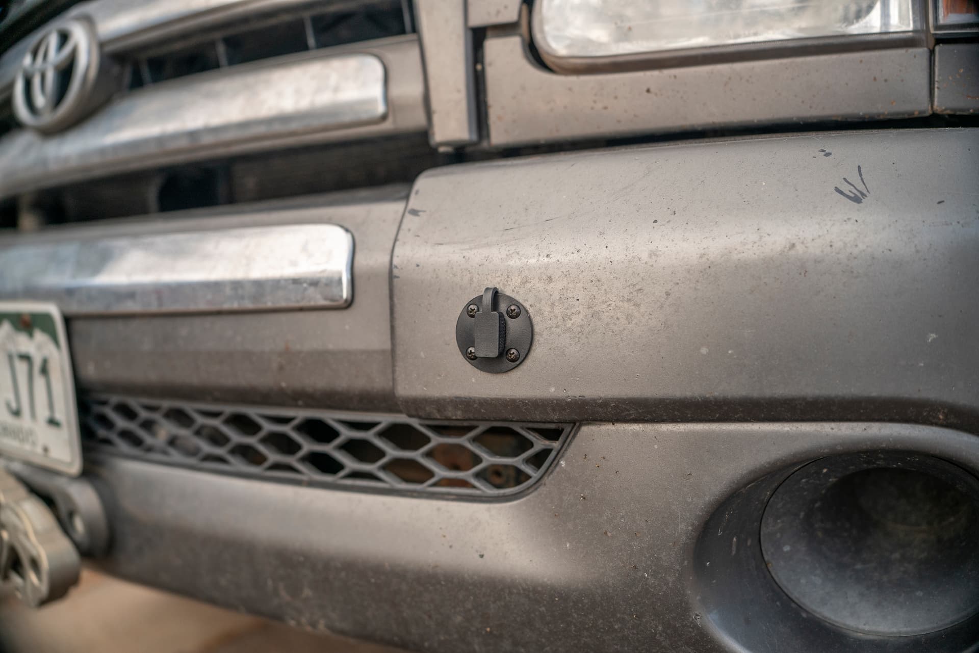

This was a pretty fun project. I’ll drop a detailed post in here soon with how and why we did it all, but the most exciting part for me is adding a port on the front bumper so we can just plug the ground panel in.
That front bumper solar port is sweet.
