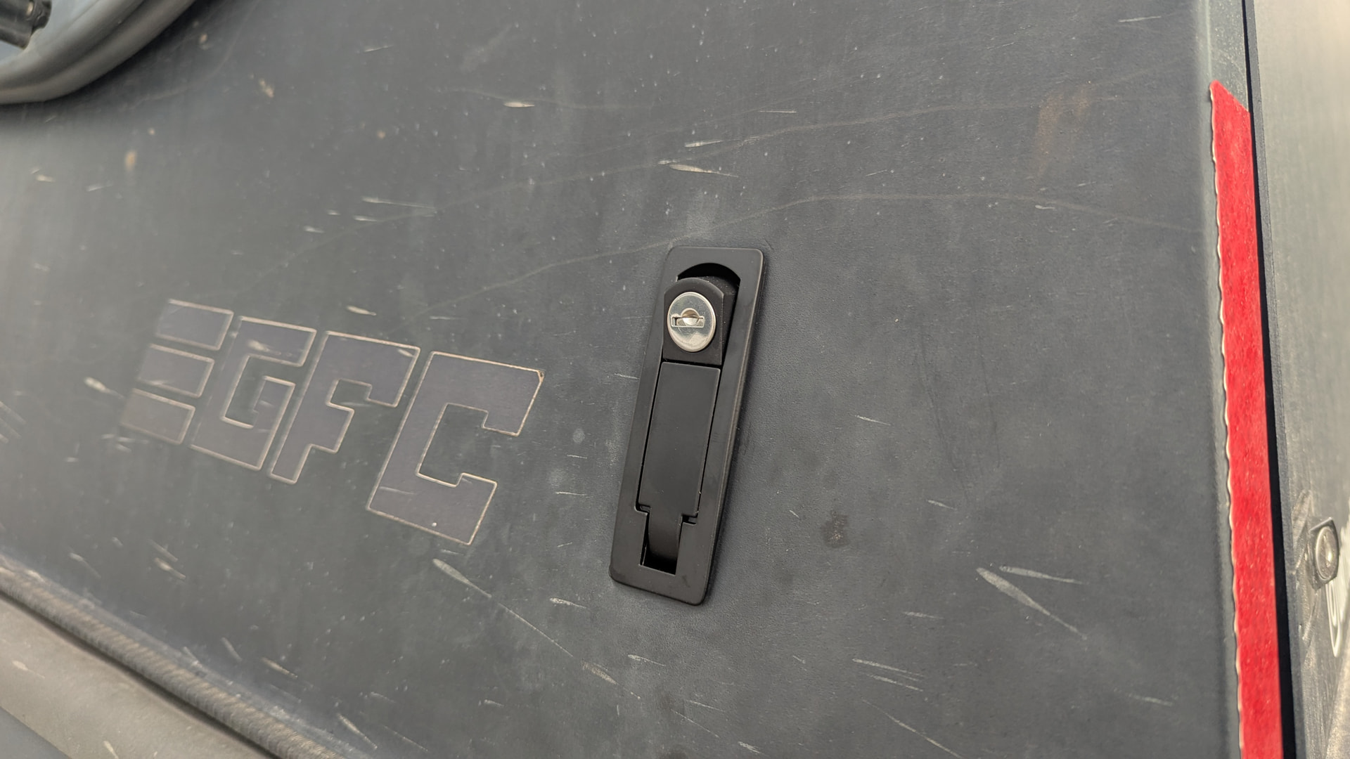

After four years of ownership, we finally had our first latch failure and got a fresh replacement in. Compared to the rest of the wear on our camper, the fresh one looks kinda out of place. :joy:

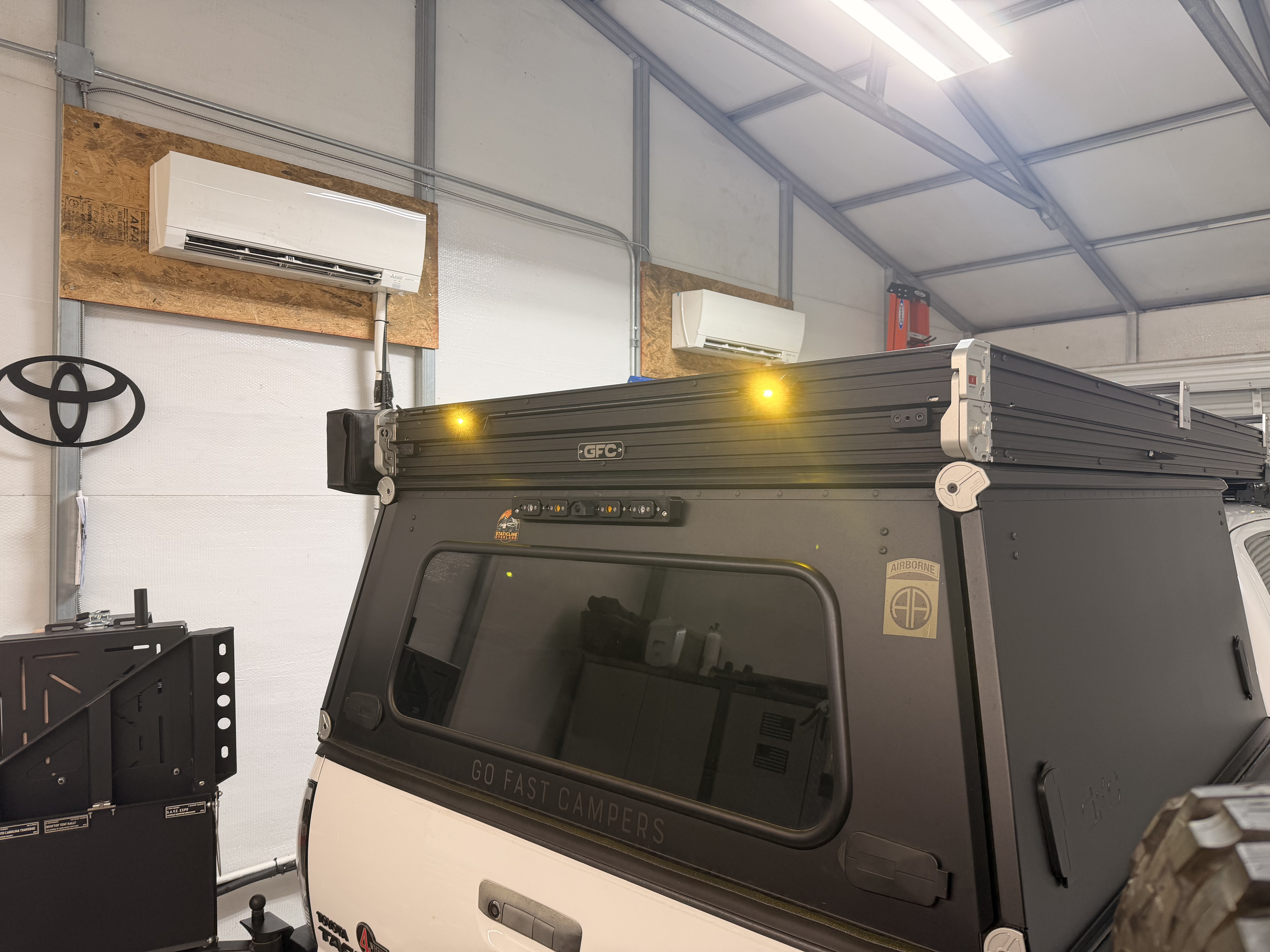

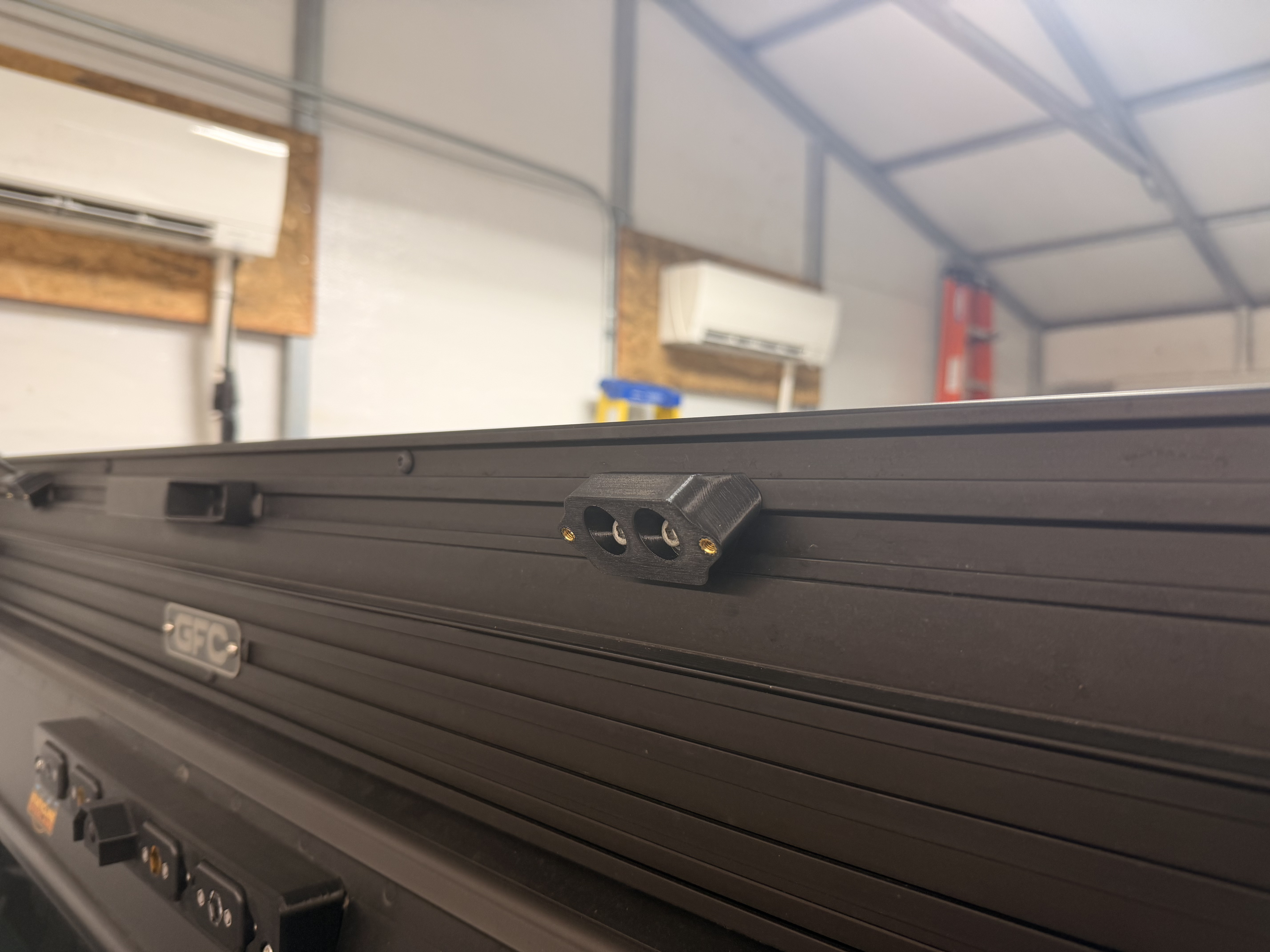

Battle Tested

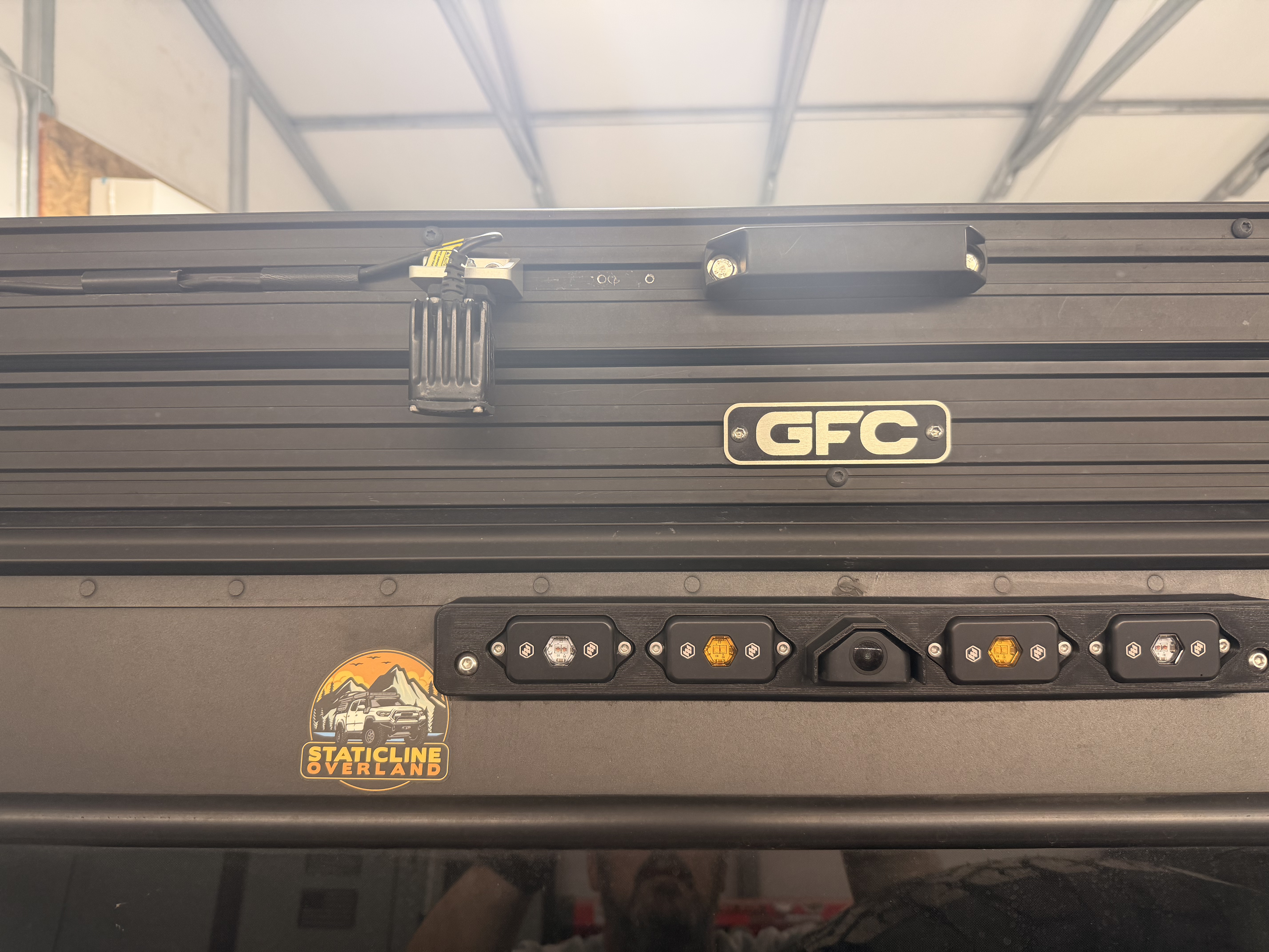

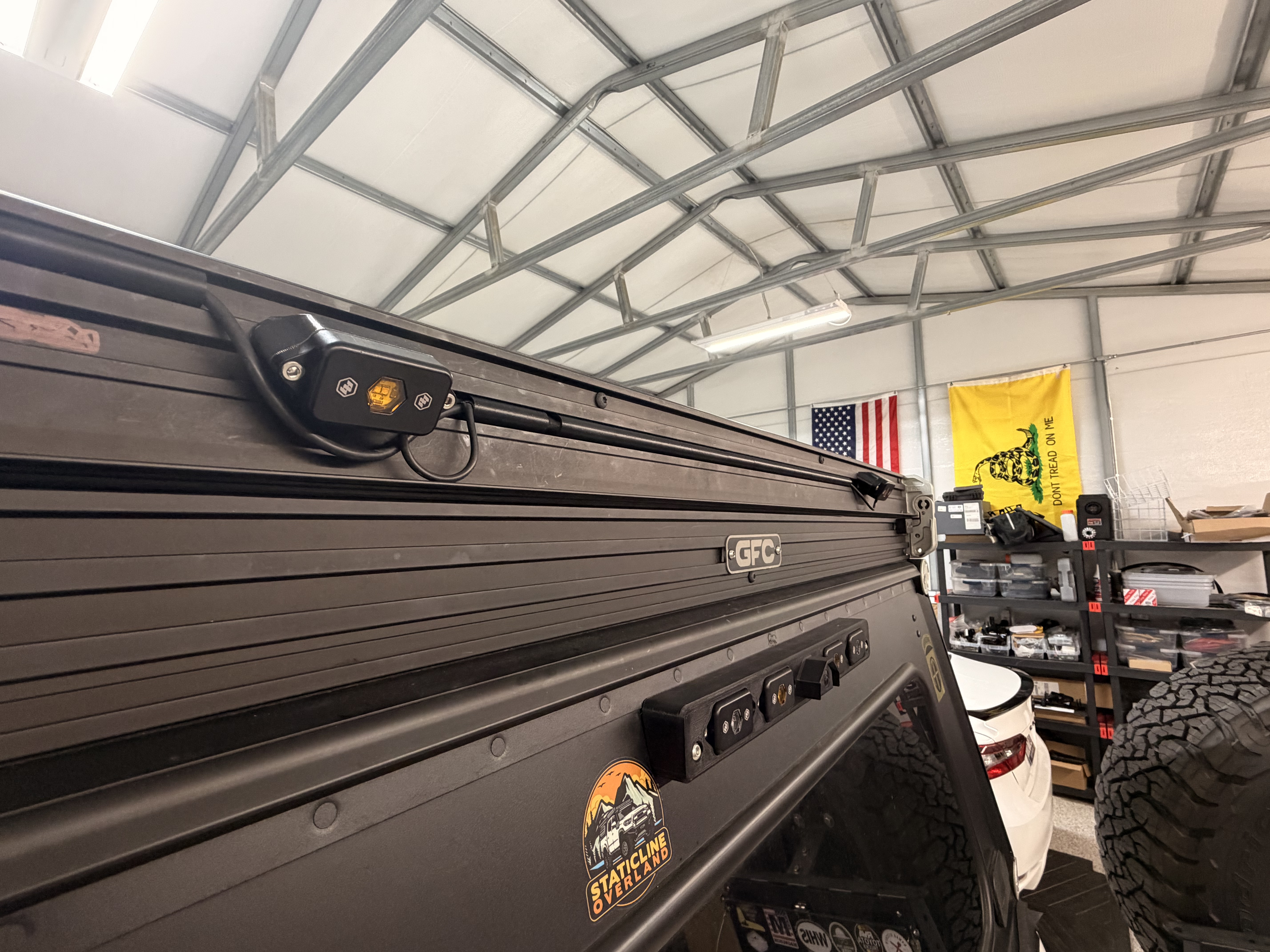

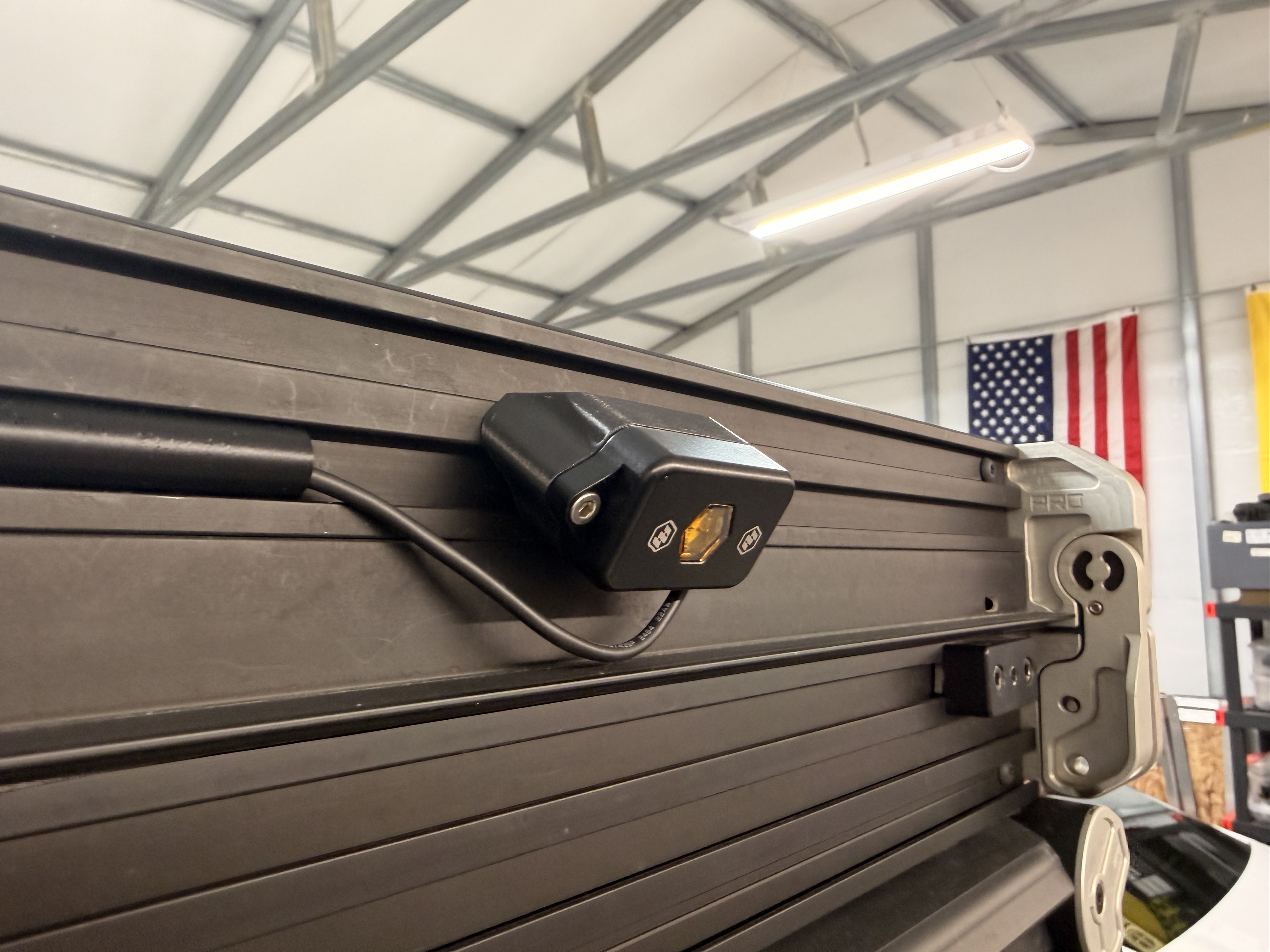

Improved the rear scene light setup…
removed the Rigid Ignite Pod…

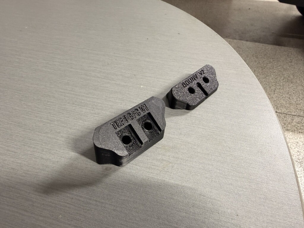

And installed two Baja Designs Rock Lights on custom mounts designed for the GFC T Slot Nuts. Mounts are recessed at the back so the T Slot Nuts pull the mount tight, mounts are also angled down 33 degrees.

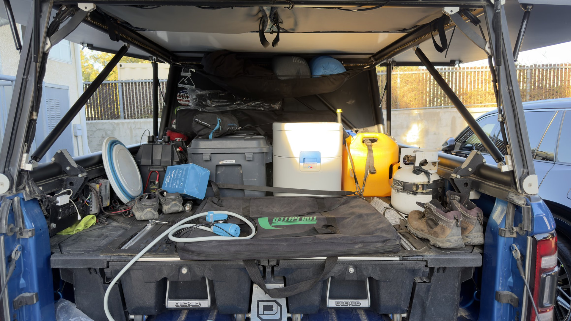

I put the throne in the GFC. It just arrived today lol
Joolca Gotta Go.

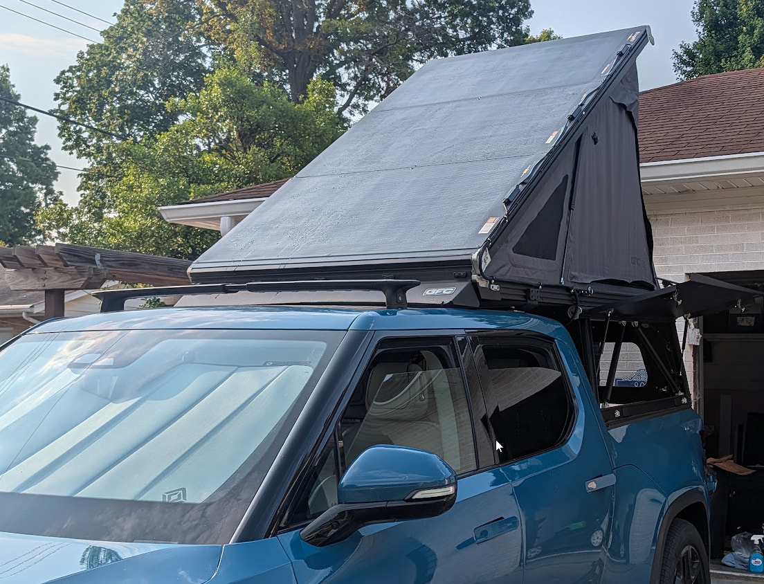

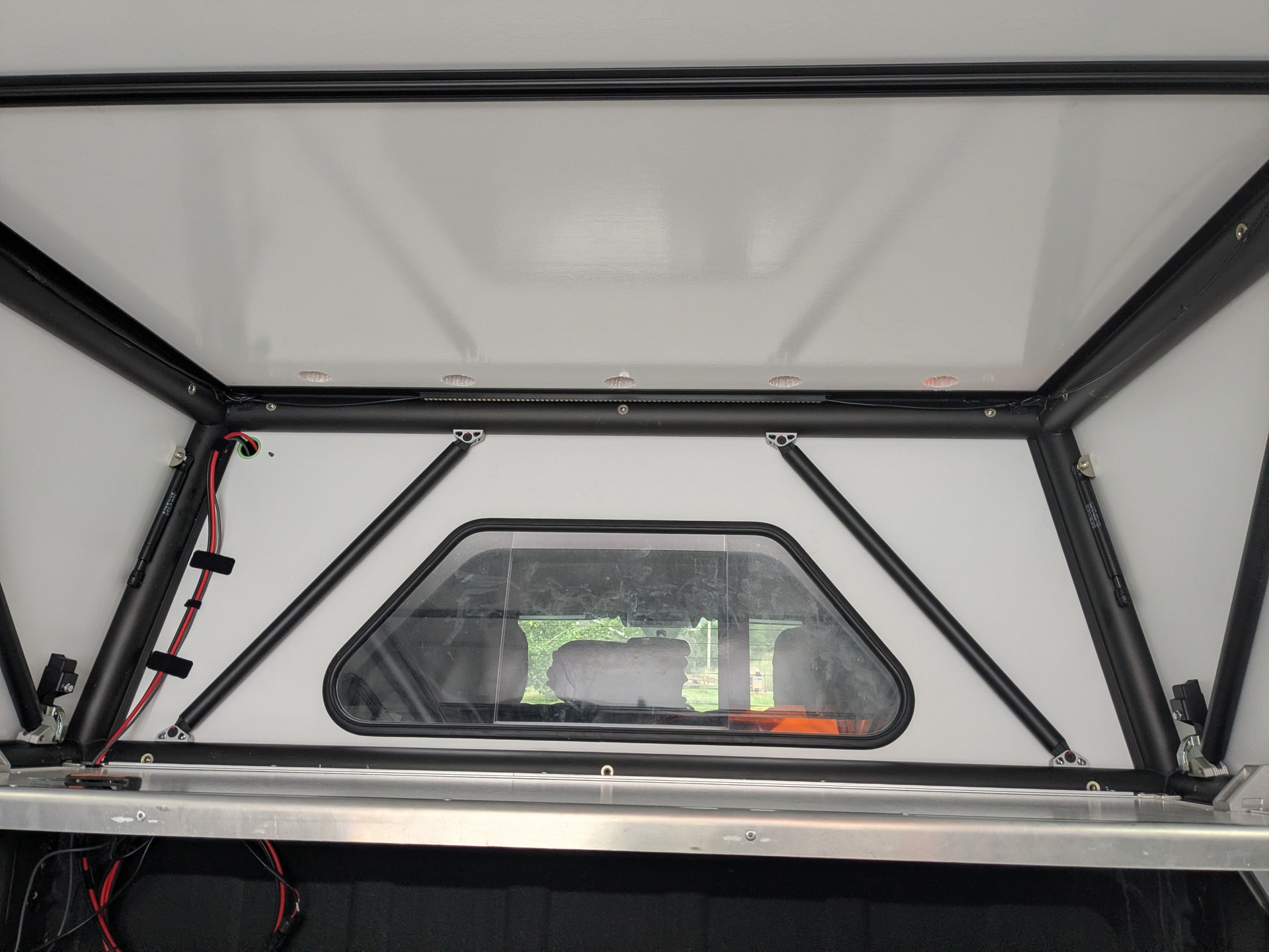

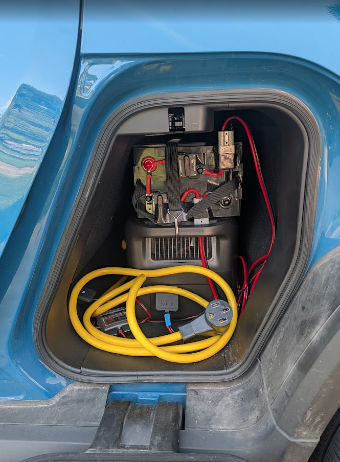

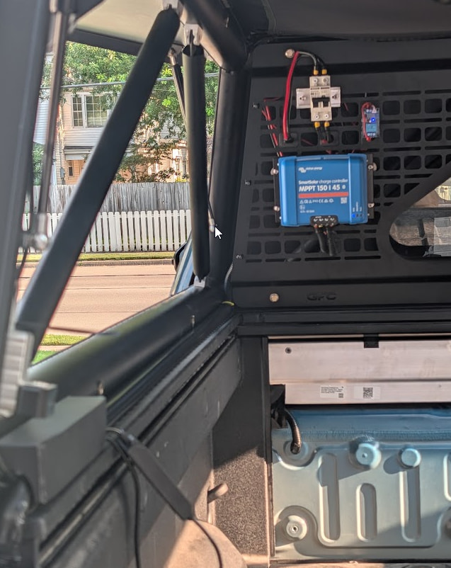

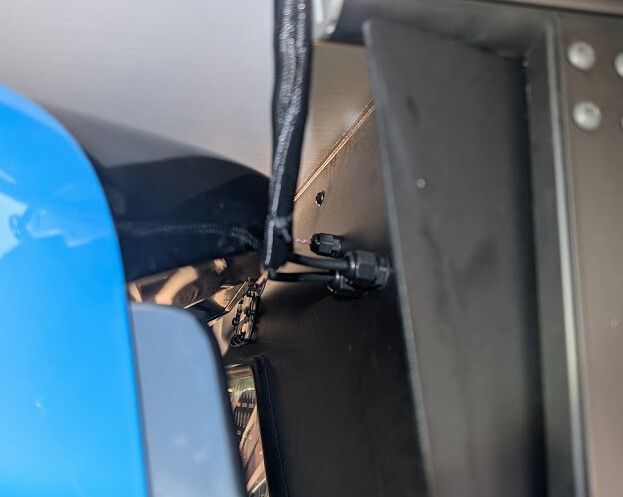

Three BougeRV Arch Pro 200watt panels are the EXACT dimensions of the roof of the V2 Pro (at least for the Rivian R1T). 600 watts going to the gear tunnel where there is a Pecron F3000 plus a 48v golf cart battery. Dumping excess power to the truck battery. Also wired a photoresistor relay using the 12v in the gear tunnel to the trucks 3rd brake light to switch the GFC brake light. Ran the wire through the existing grommet hole behind the back bed liner. Ran all the wires behind the side bed liner and then along the bed rail beside so the power tonneau cover can still function as normal.

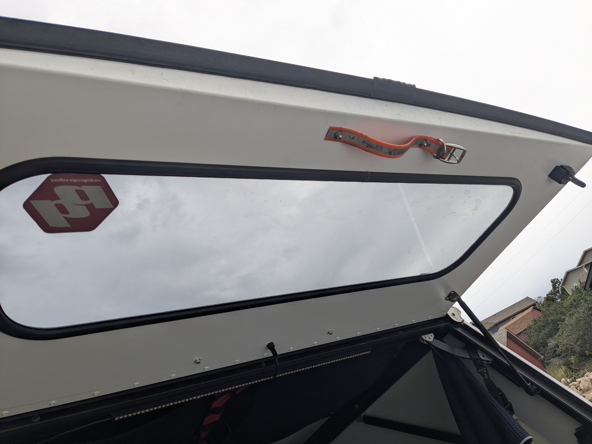

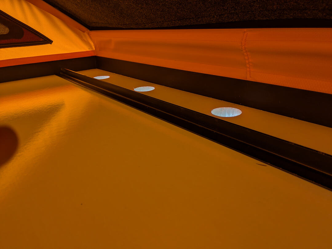

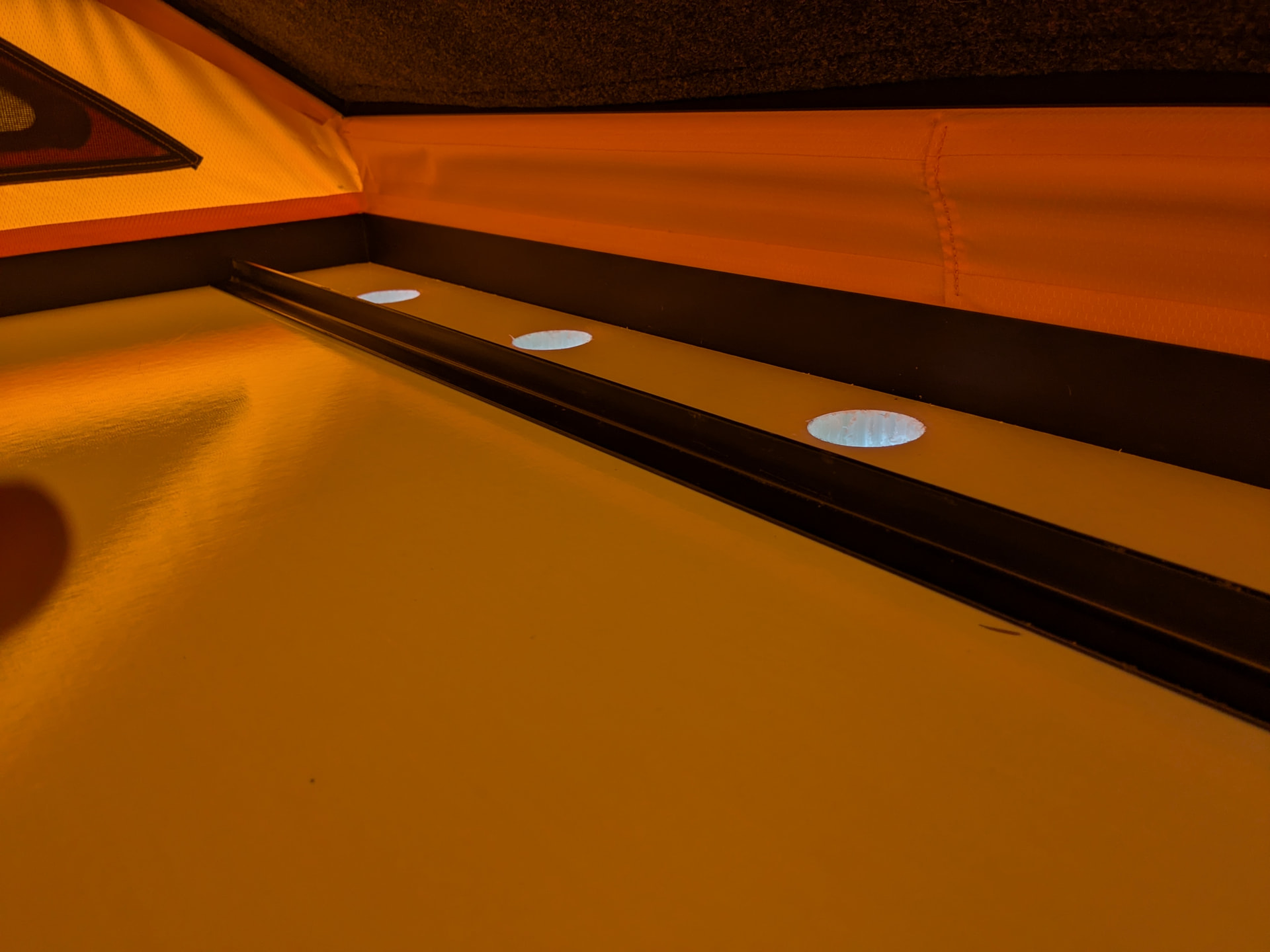

Put some passive vents for winter camping so the upstairs gets a little heat along with the downstairs where the kids are, which is the primary.
Also, put our old dog’s collar who just passed as our hatch pull.

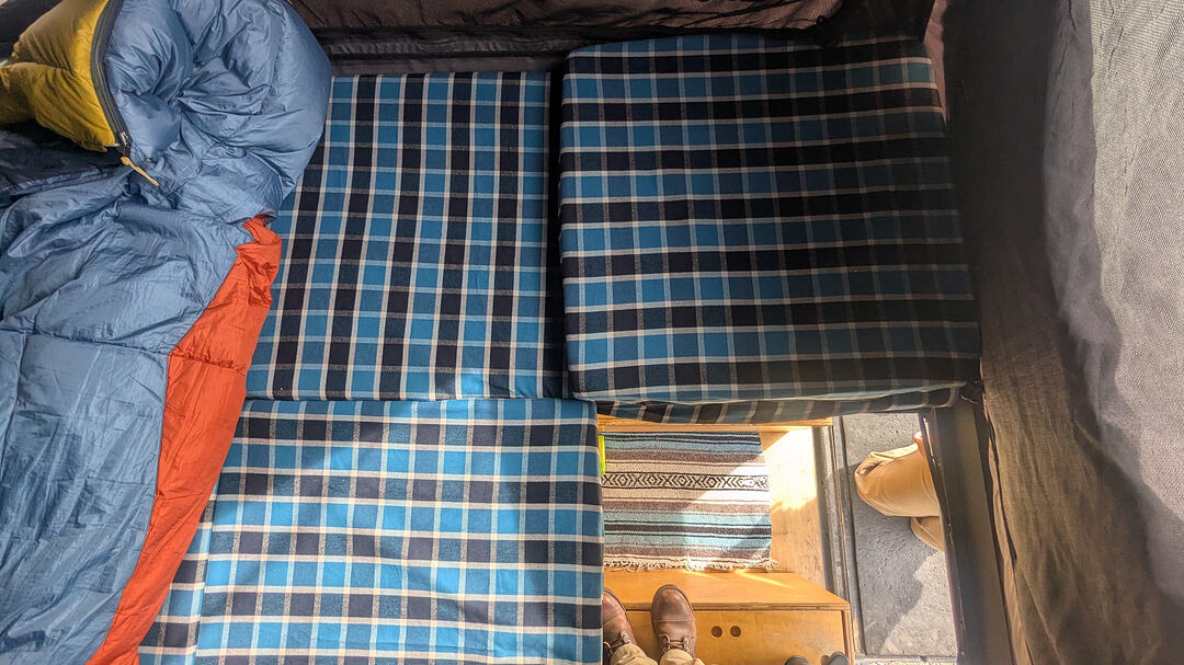

Put in some fresh sheets from Overland Softgoods, thanks @WrinkledPants for getting these out to us!

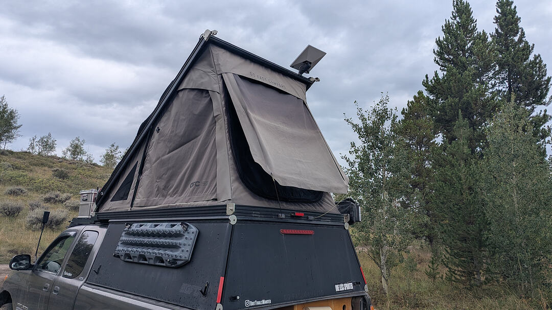

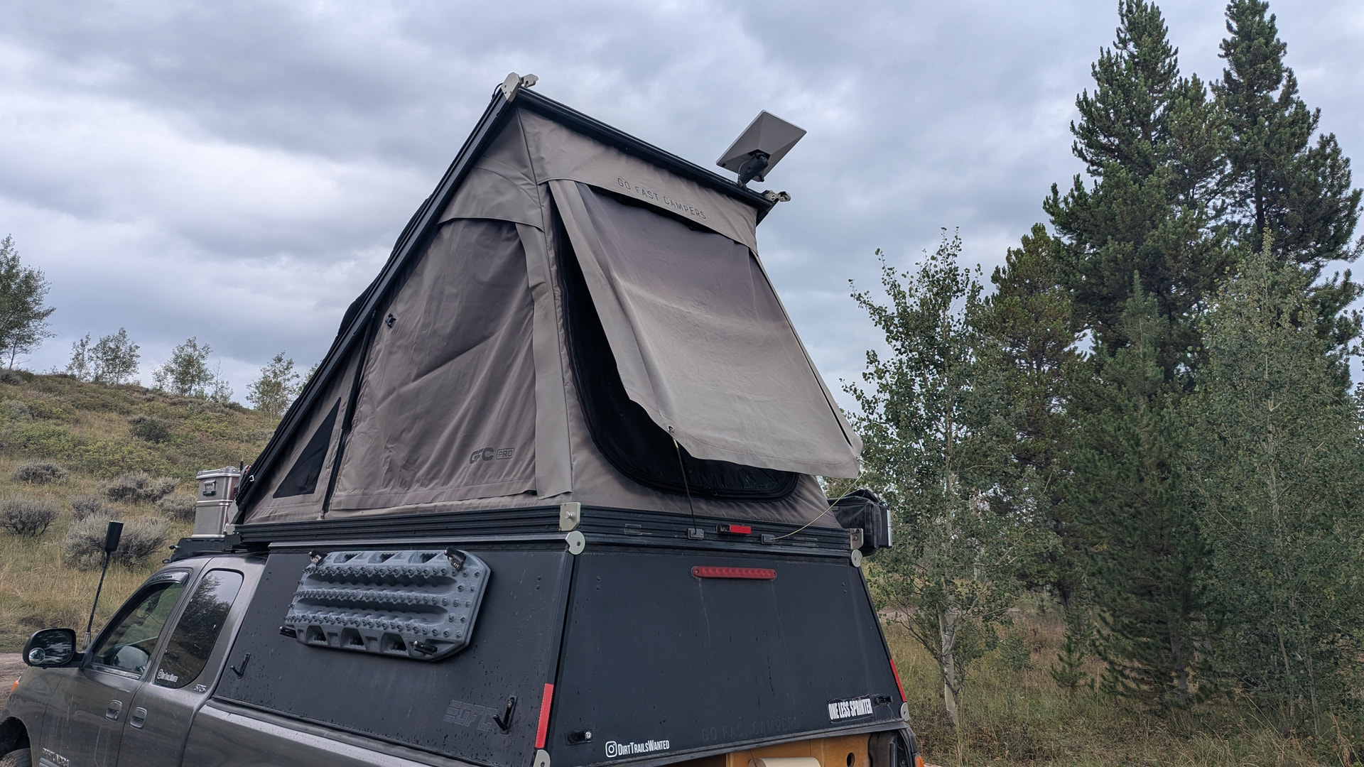

Shortened our rain fly prop arms and rearranged the anchor points so that when the rear flap rain fly is out, it’s sits a little closer to the tent. Helps keep privacy and also does a better job of blocking rain if we have to use the fly to prevent condensation over a rainy night.
I like this… I need to give that some thought.
It’s been a couple nights since we shortened the rods and I’m so much happier with it.
The long arms look great for Instagram but are way less practical at actually keeping the window open and keeping rain out.

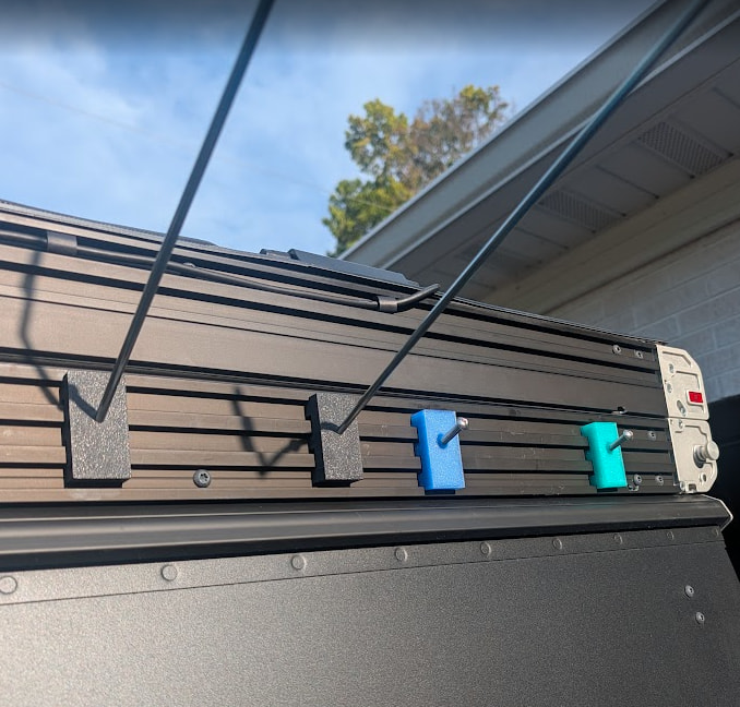

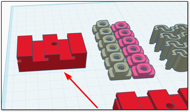

For those that have a 3d printer, you can print something like this and they work well. They just snap on and snap off the t-track. The rainfly pole fits in the hole. I use 100% infill ABS filament, and they are solid. I also have a few with a stainless steel bolt in the hole and use them to hang random stuff. When packing up, just pop them off and pack them.
Love that idea - I’d pay for the file.
