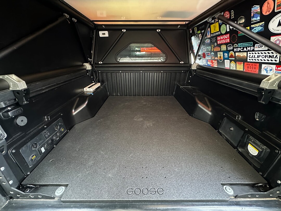

🪿 Goose Gear Baseplate install
Dropped in Goose Gear’s tacoma bed baseplate as the foundation for the new layout. Was not stoked on how their bed mounting bolts sit so drilled out a bit of the floor to countersink 'em.
Now have a fresh slate and ready to get building on second iteration of the interior :beers:
clean!!!
I was on the fence with the goose gear base plate but i think you got me over the line, this looks so clean.
its just so pricey lol. I was looking at the viato one too but they never answer any comms about questions/etc. So Goose Gear it will probably be.
They are pricey, the reason I made my own…

@shadesbro @Medicfung @Trudog I’m quite happy with the Goose Gear baseplate. This is the one piece where I felt the need to pay for a machined solution for a perfect fit (and I appreciate the plate’s water resistance). Everything else on top of it we’ll treat and cut by hand.

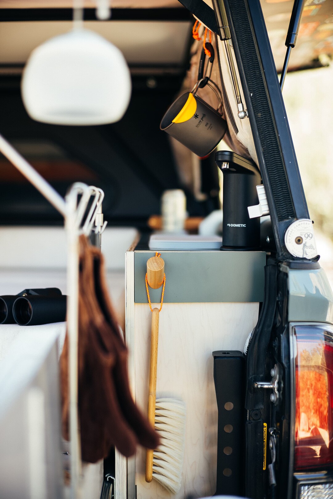

Build Update 04/03/24 — V2 LAYOUT COMPLETE
Alright! It’s been quiet here! I was heads down all of March sprinting to complete V2 of the layout before hitting the road for the next +7 months (!!!) I’m so stoked to share that the new layout is finally done—I’m actually writing this post from the truck on the Starlink at a National Monument in New Mexico.
I took hundreds of photos during this build process and I’ll go into great detail explaining every step and decision of the new layout over the coming weeks… Currently racing to get to the center of the path of totality for the Eclipse on the 8th. (:crossed_fingers: for good weather)
Sharing a few snaps below for now, see y’all out there :metal:
What an insanely cool build!! Love the attention to detail and overall clean look it has. Curious what wood you used. I am actually planning on doing a similar setup in the next month or so. ANy tips and tricks?
Good lord, just when I get my build planned out you go and raise the bar. That laptop/table placement makes a ton of sense. Also, did you match the paint to your tacoma? Nice touch.
Such a great build and great photos! Nice work as usual!
So aesthetically pleasing :heart_eyes:
